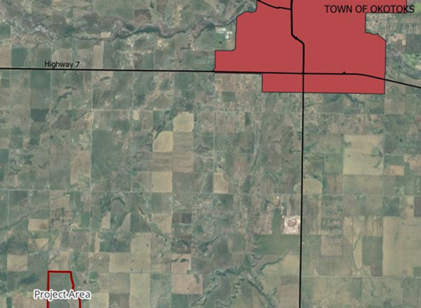

The proposed Project is located on approximately 430 acres of privately-owned agricultural land approximately 9.8km southwest of the Town of Okotoks, in Foothills County, as shown on the map to the right. The Project area has a strong solar resource, characteristic of Alberta, and will generate clean energy over its 35+ year lifetime.

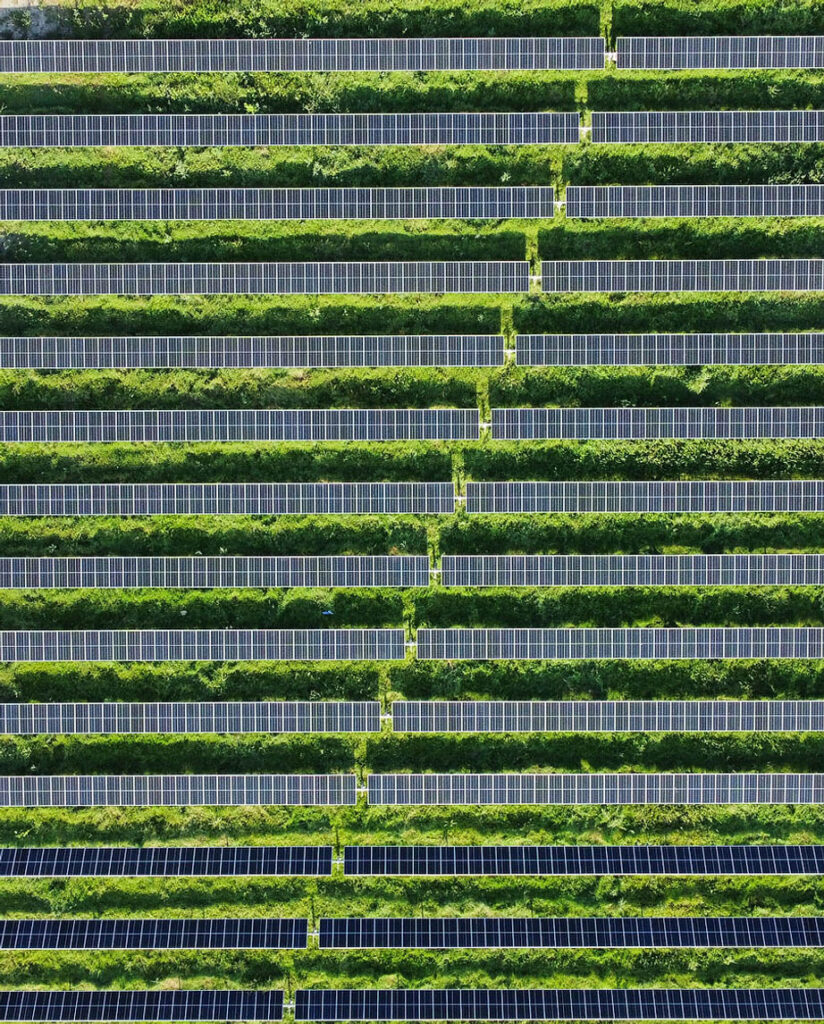

    Bifacial PV modules have been proposed for installation at the Project. A bifacial module is a double-sided module that transforms sunlight into electrical energy on both its top and bottom sides. They are different from mono-facial modules which only use one side for solar energy production. Bifacial modules are capable of producing more power per module and typically have higher efficiency than mono-facial modules, resulting in less land usage for the same or greater power output.
    Local weather conditions in Alberta are well suited to bifacial technology as there is substantials now cover on the ground, which will boost production during the winter months. One of the benefits of using bifacial modules in Alberta is that sunlight is reflected from the surface of snow-covered land, which can generate electricity from the underside of the panel.
  • Ground Mounting SystemsEnerfin intends to install the modules on a fixed-tilt system which is stationary and does not move with the sun.
